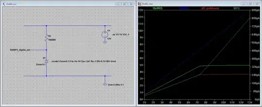

schematic and DC sweep of zener and resistor in series
As I understand it, the controlled reverse breakdown of the Zener will drop 5V from the 12V signal (and the R1 will see the other 7), and the resistor will keep the current nice and safe for the Zener (and the microcontroller?).
I don't doubt my friend, but I don't understand exactly why this is safe. Couldn't the signal short through the microcontroller and ruin my day?

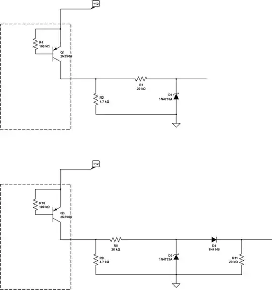

It should work fine. You might want to put a resistor (a few K ohms, it's not critical) from the sensor output to ground, assuming it's a typical PNP-output. Otherwise there will be no assured "0" level at the microcontroller input.
Also, the 100K may be a bit on the high side. I'd use something more like 20K, and perhaps put a 1K in series with the input:
schematic
The second schematic is more conservative and limits the voltage such that current into the protection diodes will not exceed a few nA under normal conditions - even with +/-100V transients at the input (but may be a few mA if a +100V transient exists and the 5V supply is not present- a value which should not result in latch-up).

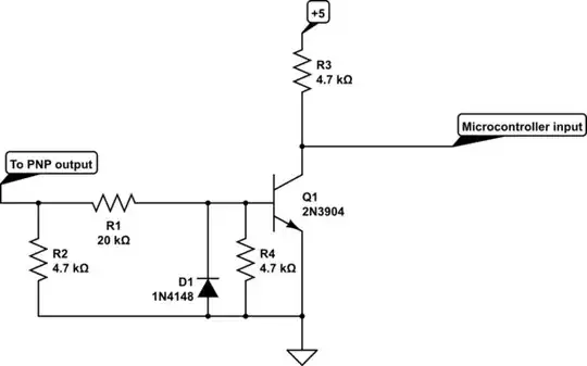

An even more conservative approach is to use a BJT as follows:
schematic
simulate this circuit
This can withstand +/-100V transients and never puts a voltage outside of the supply by more than some tens of mV on the microcontroller input under any conditions.
