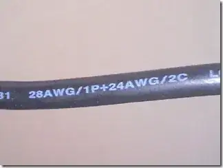

Look for something on cable like: (some number)AWG/1P. If it does exist then you have shielded twisted pair of conductor denoted by P above. And they use for data transmission.
Here: (some number)AWG/1Pdenotes
  • some number = number of wire gauge
  • AWG = American Wire Gauge?
  • 1 = Number of pairs
  • P = shielded twisted pair of conductor
28AWG/1P (for data) +28AWG/2C (for charging)

If the cable has any markings on it, look for the wire size and amount on it. They will typically say AWG 22-2 or similar for a 2 conductor of AWG size 22 cable. A 4 conductor cable would be different.
Of course, you could find a cable that has four conductors inside but not all four wires connected, so it would still be a charge only cable. But that seems like a waste of copper.

    This is a good answer. Many times the wire gauge will be different for the power conductors and the data conductors. See this image: http://www.usb-cable.com/mini-b-usb-cable-short-8-inch.jpg . If you look at the writing on the A end, you'll see "28AWG/2C + 24AWG/2C". I believe this stands for 2 28AWG conductors and 2 24AWG conductors. This would suggest it has all four conductors, meaning it can be used for charging and for data. – DerStrom8 May 27 '16 at 17:59
