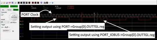

Note 4 - Atmel's documentation is not complete or easy to initially understand. For example, did you know you can access the PORT peripheral directly for some actions such as setting or clearing the OUT bits by using the PORT_IOBUS? It's mentioned, but not really discussed in the datasheet. If you understand MCU bus architecture, you would have gotten this information from the block diagrams. Here's an example of why it matters:
PORT vs PORT_IOBUS
The point of this example is to show how much faster the PORT_IOBUS operations take place than the PORT operations. There are no delays in the code, just consecutive calls to OUTTGL. Some things you can only find out by experimenting or learning from those who have already done so.
