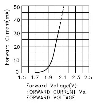

Take a look how a 2V LED might conduct: -
This is just a picture I took from the web. Below about 1.7 volts it hardly conducts any current and at 2 volts it's taking 20mA. As you can see, you can almost assume that at approximately 2 volts the current could be anywhere between 5mA and 45mA. For this particular LED, from a 6 volt supply, there would be 4 volts across the resistor with about 20mA flowing and this would lead to a resistor value of 200 ohms.
