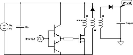

If you charge your capacitor through a resistor, the charging efficiency will be less than 50%. You should try charging your capacitor through an inductor if you are designing a power circuit.
The circuit below may not apply to your circuit because of its complexity, but you can use the forward converter topology as seen as a general solution to the efficiency problem. The major losses are only on the diodes if the MOSFET is driven properly and the transformer is designed correctly.
