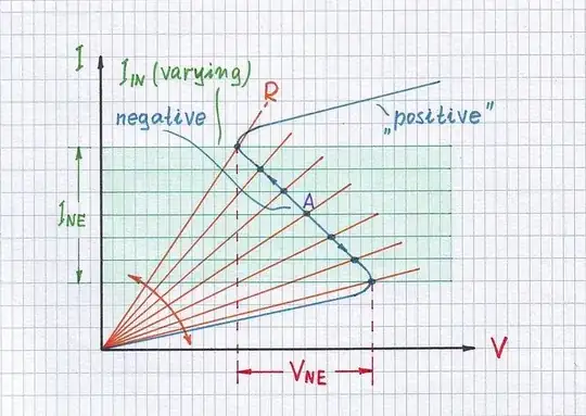

By dynamizing the initial ohmic resistance or adding a dynamic voltage we can modify its initially linear IV-curve to obtain various (even negative) non-linear resistors. Here is the philosophy of this approach.
