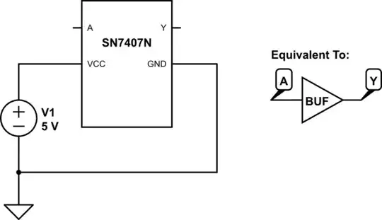

First, I put a Texas Instruments SN7407N chip on a breadboard and powered it with a 5V supply. This chip names the input side of the buffer A and the output Y.
schematic
At this point, if I connect a voltmeter to the circuit at point A (between A and GND), it reads about 1.9V. The datasheet for the 7407 indicates a low level should be 0.8V and high should be 2V. So 1.9V is somewhere in between and indeterminate. Since I haven't connected anything to A, having an indeterminate value at this point seems reasonable.
Strangely, if I measure the voltage at Y, it reads 1.4V.
Q: If a buffer's output is supposed to mirror its input, why does it not read the same 1.9V as A? Perhaps I shouldn't be concerned since A and Y aren't connected to anything, but I do like to understand what is going on when possible.

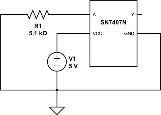

So the next thing I did is connect a 5.1kΩ pull-down resistor R1 to A like so:
schematic
simulate this circuit
Now, when I measure the voltage at A, the meter reads 1.6V (a drop of .3V).
Q: Since the pull-down resistor is supposed to create a low-level at the buffer's input, why doesn't it show something closer to 0V at A?
Measuring at Ynow shows .9V, which maintains the roughly .5V difference I saw when nothing was connected, but the voltage at Y still appears to be too high to present a true low condition.
I am aware that the buffer is an open-collector, and now I'm wondering if the reason I'm seeing unexpected results is because Y isn't connected to anything.

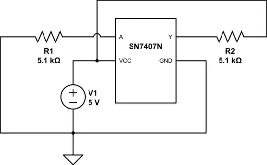

So I tie a pull-up resistor R2 to Y like so:
schematic
Now, when I measure the voltage at A, it still reads about 1.6V. However, the voltage at Y is now 5V! Does this represent a high logic level (since it's greater than 2V), or is there an error in the way I've hooked everything up since it is now reflecting exactly the VCC voltage?
I realize I haven't finished the circuit exactly as the one above from Wikipedia shows (i.e. no connected N-channel FET or relay), but the values I see by measurement already don't make sense.
Should I have connected the rest before writing this question? If the answer is yes, I think I'll be even more confused because that implies the load dictates the logic values (which of course it shouldn't). I thought I should be able to establish clear states simply with the use of pull-up/down resistors.
