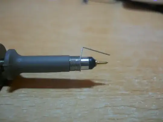

Sometimes you need to ensure that your oscilloscope probe ground lead is not creating measurement error such as ringing and overshoot. In various forms, I have seen (and successfully used) a ground spring for measuring a circuit. I have shamelessly borrowed AndrejaKo's image to make sure we're all on the same page:
Oscilloscope probe with spring-type ground connector
I have determined that this lead length is essential in some of my test configurations, but it requires constant attention to make sure I'm not shorting something out, loosing a connection, or probing the wrong thing. This limits my ability to do other tasks in the test setup, and makes it impractical for other setups that do not allow that sort of access safely (blind or hazardous conditions).
How do I attach a scope probe to the circuit under test with a 1/2" (1cm) ground lead, or otherwise get a hands-free high bandwidth setup?

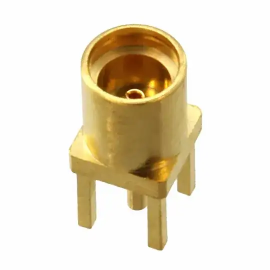

The kind of tip you show is not intended for permanent installation.
If you need to have a scope hooked up to the device under test, with good high frequency performance, the only good solution is to design testing connections into your device.
I like MMCX connectors, because they're very compact, and you can get MMCX->SMA pigtails (and convert that to BNC) for cheap.
You do have to design testing into your project, but it's a good habit to get into anyways. I tend to try to scatter MMCX footprints around my board layouts, so I can get easy probe access to any nets I'm interested in. Plus, they make decent pads for probing with a spring ground clip if you don't want to solder connectors down.
You can also make a homemade alternative, if you have the board-space and patience:
As W5VO points out in the comments, using a test-setup like this for high-speed connections can be somewhat challenging. You would need to either construct a 10:1 probe adapter with a compensation capacitor, and mount it right on the mating MMCX connector, or properly ensure that your connecting cable is 50Ω, and the oscilloscope you're using is set to 50Ω input impedance to prevent reflections and signal distortions.

    To sorta flesh the RF connector thought out, you would be running the scope as a 50Ω input, and use a resistor-divider technique to get the amplitude to an acceptable impedance and voltage range? – W5VO Oct 31 '14 at 13:43
    @W5VO - That depends on whether you're trying for low noise or controlled impedance connections, but for the latter, yes. – Connor Wolf Nov 01 '14 at 06:07
    My concerns are with fast rising and falling edges, and my voltages are high enough that I can't use 50Ω mode directly. I'd imagine you'd get a bunch of nasty transmission line effects if you just used 50Ω coax straight to the 1MΩ input of the scope. I'm trying to minimize ground loop for high-speed signals. – W5VO Nov 01 '14 at 08:13
    @W5VO - That is a completely valid point. I'll admit that I primarily use embedded connectors like the one I show to get a very robust, low noise connection so I can do high precision analog verification, all at frequencies well below 1 MHz, so I have not really considered the high frequency requirements. You make excellent points. – Connor Wolf Nov 01 '14 at 08:44
    Basically, another advantage of this sort of test-setup is that, provided your device-under-test is not grounded to earth, you get a very good quality local ground connection (and no ground loops) with a RF connector. When you're looking at < 1 mV signals, having just the ground clip lead running to a ground connection a inch or two away can swamp your signal of interest with ground differences. – Connor Wolf Nov 01 '14 at 08:46
  • @W5VO - Added some more thoughts on how to use a setup like this for high-speed probing. Opinions? – Connor Wolf Nov 01 '14 at 09:02

First, wind the bare buss wire around the probe (as you see in the photo); it will be loose and not quite stay on. The trick is you next take it off, and give it a gentle little squeeze (deforming it maybe about 0.1mm smaller), so that it is slightly smaller than the diameter of the probe. This ensures that it will fit snugly when you insert the probe.
If you want a more reliable way to generate these "ad hoc" scope probe ground jacks, check your local hardware store for some wooden dowel stock in the nearest size smaller than the probe body. Then, when you wind the wire around the dowel stock, the resulting "spring" will be smaller than the probe body. If it's too small, you can gradually increase its thickness by winding electrical tape around the dowel stock until it is the right size.

    I think the OP is tring to find the mest method to get a reliable connection form the spring to the device under test - not between the spring and the probe. – RJR Oct 28 '14 at 06:11
    As RJR suspects, I don't have any issue making or using the traditional spring ground clip, my problem is that it doesn't stay connected to the circuit if I remove my hand. – W5VO Oct 28 '14 at 06:17
    Solder it in place? – MarkU Oct 28 '14 at 06:24
  • You would solder the tip of a $500 scope probe to your board? – W5VO Oct 28 '14 at 06:38
    No no, don't solder the actual scope probe -- I mean just solder the buss wire "spring". You can make one coil to fit the ground sleeve of the probe, and a smaller coil to fit the probe tip. – MarkU Oct 28 '14 at 07:36
    Once you solder the spring you can wind some 30 gauge bare wire around the tip making a small socket for the tip. Twist the two ends of the wire while it's still around the tip to form a tail, (and to make it tight) solder the tail to the test node, solder the ground spring you made above to a ground the right distance away and you can have a semi-permanent scope probe socket on your board. – John D Oct 28 '14 at 16:03
