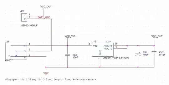

Just a connector? Battery connects at J21 power supply at J29. When supply is plugged in it breaks the GND connection for the battery.
