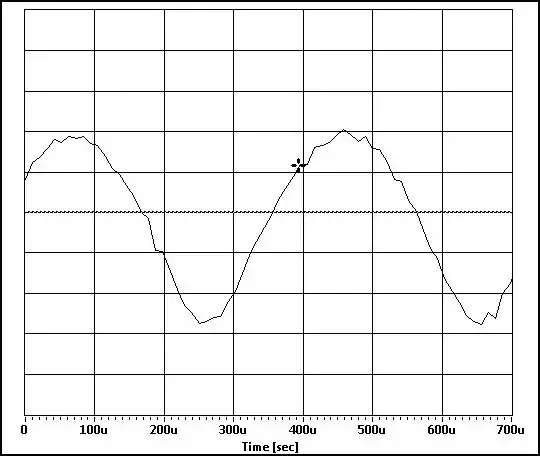

Now about the results: When I power on the device and sent a 1 kHz sine wave to it, I get this:
sine wave
The peak to peak voltage here is around 190 mV.
When I turn it off, I get this:
distorted sine wave
and the peak to peak voltage is around 1.46 V.
So it works much better when it's off than when it's on.
