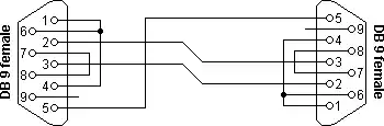

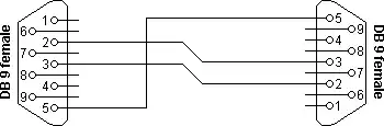

A) In my case, as I develop my own PC software, I've never used other pins, only RxD, TxD and GND. So, in this case you can left other pins open. This is called as null modem without handshaking
B) Yes (assuming GND is being considered)
C) Again, it will depend of the software on PC side. Some softwares you can configure to not take care of hardware control. Others will require RTS/CTS handshaking, so you can do a null modem with loop back handshaking
Source of the pictures: RS232 serial null modem cable wiring

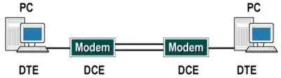

EIA-232 defines DTE (Data Terminal Equipment, in this case your PC or SBC) and DCE (Data Communication Equipment, often a modem).
DTE-DCE configuration
You have several ways to connect the PCs.
  1. A direct connection, without the modems, uses a crossover cable (RxD on one side is connected to TxD on the other side, and vice versa). You only need those two signals + ground. That's what you use to connect a PC to a SBC.
  2. A modem connection uses the extra signals too, the PC and the modem are connected via a straight through cable (pin 1 connected to pin 1, etc.)
  3. You can set up a connection between two DTEs as if there are modems present, in that case you use a null-modem to connect control signals between DTEs, like RTS from 1 DTE is connected to CTS on the other. This uses a complete wired crossover cable.
  4. A null-modem setup, where the control signals aren't connected between PCs, but you cheat and don't connect RTS to CTS on the other PC, but on your own PC. Other signals are also locally looped back. The result is that like in case 1) only RxD, TxD and Ground are connected between PCs.
