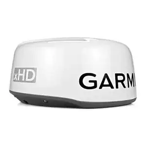

This is related to coverage of radars with specific materials, overall construction calls "RADOME" - Radar Dome, mostly used for protection.

Is it something like a term for a collection of radar obstructing materials?
No, it's supposed to be an RF transparent cover for the antenna(s), and it's traditionally called a "RADOME".
Because it's not completely transparent it reflects a little non-Doppler shifted RF into the receiver, which causes the problem (akin to "ground clutter" for a pulsed RADAR) the data sheet was referring to.
