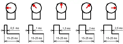

This diagram might help: enter image description here

  • what i should do if i want go back to the Postion 0 ? – Dana Sorani Sep 19 '14 at 18:15
  • diagram is very nice. – tcrosley Sep 19 '14 at 18:16
  • change pos. Try int pos = 1000; or int pos = 500; for one direction, and int pos = 2000; or int pos = 2500; for the other. – gbulmer Sep 19 '14 at 18:17
