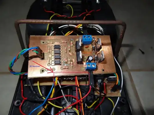

Inside my RC car
Detail of where the RF receiver is

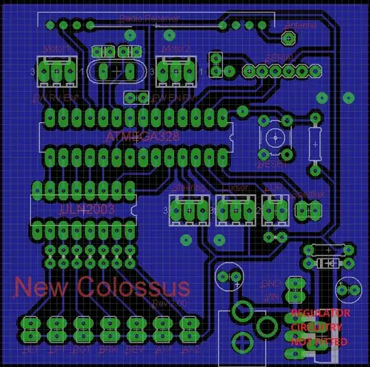

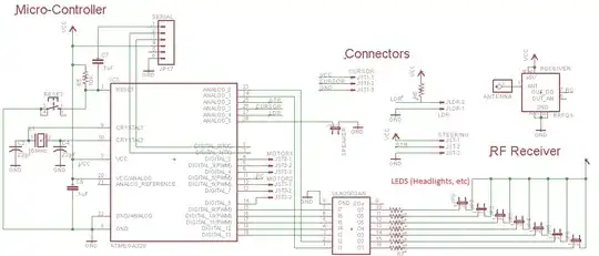

Below are the board schematics and design.
Car electronics schematics
Car electronics board

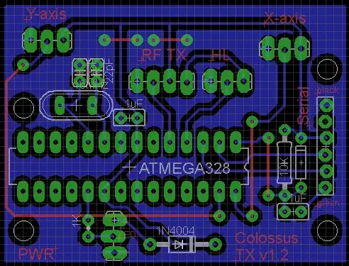

The controller schematics and board design are below.
Controller schematic
Controller board

From items 1 and 2 above I can tell that the problem has something to do with the main motor interfering with the receptor module. Maybe some shielding would help. From item 3 above, it seems that the LED wiring is also interfering with the communication. But that's all I can tell.

    Is your power supply up to snuff? – Passerby Sep 07 '14 at 23:12
  • @Passerby - What do you mean? Which of the 3 power supplies? What is snuff? – Ricardo Sep 07 '14 at 23:19
    I'm surmising a little, here, but your question's title says this happens at full speed, and you say you've connected the "grounds" of all three power supplies. "Ground" isn't really ground, it's just the negative side of all the power supplies. Could your "drive" power supply be "pulling up" the ground when it's being fully taxed? Do you have any way to measure the effective voltage of the power supply while the motor is fully taxed? (On a bench.) Just a thought. – Wesley Long Sep 08 '14 at 00:01
  • @WesleyLong - that's a good idea, thanks! I can put the power supplies through the scope and see what's happening. – Ricardo Sep 08 '14 at 00:04
    I'd not use the scope. I'd use a DMM (Digital Multi-Meter). The ground on your scope's probe is (likely) connected to the AC ground from the wall, and would invalidate the tests's conditions. A DMM (battery-powered) would not. – Wesley Long Sep 08 '14 at 01:42
    Up to snuff means up to the job/task. @wesleyLong explained what I meant. If the battery supplies, at full motor load, is changing the available voltage (or creating a lot of ripple), it can affect the receiver. Check the voltage rails under load. A scope is better than a multimeter imho, but check with both anyway. – Passerby Sep 08 '14 at 16:42
  • Thanks, @Passerby! I'll take a look at the supply with my scope and DMM. I found this post elsewhere that is close to what you and wesley are getting at. – Ricardo Sep 08 '14 at 18:23
The RX and TX modules are very crude and do not feature an automatic CRC handling, so you should do it in software, along with some error correction coding.
The receiver requires \$5\,\mathrm{V}\pm 0.1\, \mathrm{V}\$, so with 4 AAs you probably need a boost (or perhaps buck/boost) converter.
Brushed motors generate EMI by arcing at commutator, so shielding and placing it farther from the receiver should help. Or get a brushless motor.
