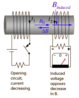

Next is understanding what M is in a bit more detail. This site shows a good picture: -
Note the formula - it says that the induced voltage in a 2nd coil is: -
Induced voltage = \$-M\dfrac{\Delta I_1}{\Delta t}\$
This allows you to determine M by injecting a sinewave into the 1st coil and integrating the voltage sinewave produced on the 2nd coil.
Once you have actual M you can calculate the coupling coefficient, k using the \$M_{real}\$ formula given higher up in my answer.
