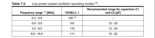

Usually 5pF will suffice for a crystal pin plus stray capacitance with reasonable layout (as short traces as reasonable, possibly over a ground plane). However, the AT90USB1286 datasheet does not recommend load capacitors of less than 12pF so 10pF total would seem to be marginal (you'd get 11pF if the input+stray was 5pF).
http://www.atmel.com/Images/doc7593.pdf
If you don't care about the exact frequency, 12pF or even a bit higher would probably be okay with a "10pF crystal", it would just shift the nominal oscillation frequency very slightly. Otherwise you can pick a different crystal.

  • I try to achieve accurate (16MHz) clock, i.e. use low-ppm (10ppm) crystals. Maybe capacitance non-matching adds more error than I gain with more accurate crystal, i.e. answer is avoiding 10pF crystal. You're right, recommendation is 12-22pF and probably both conditions should be satisfied. – TMa Sep 01 '14 at 15:44
