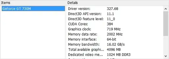

For example, SpeedTest.net boasts that it can test your "internet connection bandwidth", and NVIDIA graphics cards report "memory bandwidth" in GB/s:
I always found it confusing how the term "bandwidth" is used for something that is measured in bytes per second.
