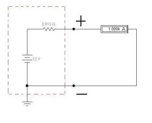

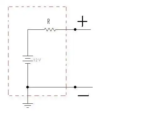

the answer is very simple just the internal resistor of the adaptor i give you an exemple 1-open circuit (no current) only the voltahe of your adaptorenter image description here
2-the 5A case: theoriticly you get 5A if you have a load of 2.4ohm I=V/R I=12/2.4=5A with my simulation i got 4.998 which is close to 5A but the load is the internal resistor which is 2.4ohm enter image description here
3-the 1000A theoriticly you get 5A if you have a load of 0.012ohm I=V/R I=12/0.012=1000A which is the internal resistor for such internal resistor you should have a reactor not adaptor :) enter image description here
no matter what is the polarity of the adaptor, the relation will be the same l I l=l v l/R for example if we have a transformer ((most of the adaptor have a transformer inside)) than sure we have an ac current, i.e. the polarity will be change but the internal resistance will be the same (no change) and it will be effect on the current if you want to make a small internal resistance you should have a big transformer with big diameter on its coil to make a small resistance as possible, so the more biggest transformer (adaptor) the more low resistance and effective adaptor
I talk about the internal resistance if it is a dc adaptor (battery of electrochemical element), but if it is an ac (transformer og generator) it will be the impedance

  • This doesn't answer the question. If making a 12-V 1000-A supply is just a matter of reducing the internal resistance, then why don't we just do that? – The Photon Sep 25 '14 at 16:29
  • @ThePhoton - because reducing the internal resistance isn't easy or free. But conceptually, reducing the internal impedance (at a given load) is essentially what is done to make a higher current design. – Chris Stratton Oct 01 '14 at 16:52
  • @ChrisStratton, I know that. I'm asking the poster to improve their answer by including this information. – The Photon Oct 01 '14 at 17:20
  • That would depend on the internal details of the unspecified adapter - only speculation is possible. – Chris Stratton Oct 01 '14 at 17:23
  • @ChrisStratton, OP didn't ask about any particular adapter, he asked why all adapters aren't designed to provide up to 1000 A. This answer doesn't give wrong information, but it doesn't answer the question that was asked. – The Photon Oct 01 '14 at 17:33
  • @ThePhoton - and my point is that 'what specifically is hard about decreasing the internal impedance' is a question that can only be specifically answered for a specific category of circuit - which has not been specified. Ask a generic question, get a generic answer... – Chris Stratton Oct 01 '14 at 17:34
    @ChrisStratton, I think the other answers show that it is possible to give a useful answer. This answer doesn't usefully answer the question that was asked. If you think it does, you can give it a +1. In the meantime, I'm not sure why you're pissing on me for suggesting ways for m salim to improve his answer. – The Photon Oct 01 '14 at 17:40
  • The other answers merely speculate at the internal design, and answer in the context of those guesses. – Chris Stratton Oct 01 '14 at 17:46
