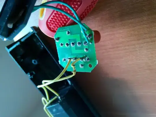

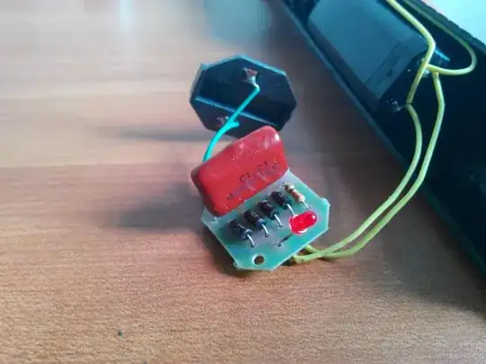

I disassembled a Chinese-made flashlight and found they use just capacitors to bring down the voltage instead of a transformer. They are using it to charge small lead-acid battery.
My question is how a capacitor alone can be used to bring 220 V down to 6 or 12 V?
Top-view
Bottom-view

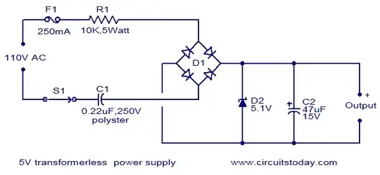

A capacitor is an impedance and at (say) 50 Hz, a 1 uF capacitor will have an impedance of 3183 ohms - if you put this capacitor directly across the AC (at 220 V), the current that would flow is about 70 mA.
OK, so it's not directly across the AC supply because it feeds a bridge rectifier and battery but it will provide a decent enough source of current to charge the battery. The voltage is limited by the battery itself.
Be aware that this type of circuit is not isolated from the incoming AC and stripping it down is OK providing you don't switch it on while still stripped down—the voltages are lethal.
Here's something like the circuit it uses:

  • cap charges in half cycle so current may be ~~~ double what you calculate at 220 VAC. No? – Russell McMahon Aug 25 '14 at 12:51
  • @RussellMcMahon peak current could be about 1.5 x I guess but it's a crappy looking implementation without a real circuit so there's a lot of guesswork here. – Andy aka Aug 25 '14 at 13:10
  • In circuit you give as example, why do we need the C1 capacitor (this is to have some impedance, so voltage lags current, but why?). Also : why do we need that Zener diode D2 ? Isn't the bridge rectifier enough ? – tigrou Aug 25 '14 at 15:05
    @tigrou the capacitor acts as a current limiter for the zener and the zener acts to limit the peak dc voltage - without the zener, the DC voltage would be peak AC voltage. – Andy aka Aug 25 '14 at 15:09
  • @tigrou In this scase there probably is no zener BUT the battery acts as a clamp making the supply a constant current source. – Russell McMahon Aug 26 '14 at 04:21
  • @andy - see comment above. – Russell McMahon Aug 26 '14 at 12:15
  • @RussellMcMahon I did say that the circuit I added was "something like" and I agree with the battery acting like a clamp as I also said "The voltage is limited by the battery itself". Pi*s poor design but what price on life LOL – Andy aka Aug 26 '14 at 14:43
  • @Andyaka How much will the capacitor dissipate? As much as a resistor of the 3183 ohms? – Guillermo Prandi Aug 28 '14 at 01:07
  • @GuillermoPrandi capacitors don't dissipate heat - they are reactive components - they just impede. – Andy aka Aug 28 '14 at 07:04

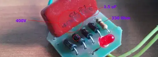

Suspect circuit:
The circuit is probably as per Andy Aka but from the photo, it does not have the R1 high voltage series R, the zener, the fuse and possibly not the C2 output cap (which MAY be with the battery).
This is a "universal" light as the 400V rated cap may just about survive on 230 VAC, but the battery will be boiled twice as fast when using 230 VAC.
The missing R1 was intended to provide some voltage dropping but, more importantly, to provide some surge protection. If there are exposed power plug pins when mains is disconnected, touching them both will give you direct body access to the 20 mili-Joule which could be stored in the capacitor. Not enough to use as a defibrillator but certainly enough to ensure that you never voluntarily touch them ever again when charged [ask me how I know :-) ]. Unlikely to kill with single cap shock. Could. Muscle spasm or involuntary arm motion from shock may cause your arm to encounter nearby objects at speed and with force.
The diodes appear to be 1N4007, so they have done something right :-).
The missing fuse is meant to help in the event that the cap is not as AC mains rated as you'd hoped and fails short or some approximation thereof. The IN4007 diodes will probably make OKish standins.
The 330 Ohm resistor is probably used to power the power-on LED.
The battery is (apparently) used as the voltage clamp.
If it's a 6V battery then
$$I_{LED} \approx\approx = \frac{V_{bat}-V_{LED}}{R_{LED}} = \frac{6.5-2}{330} =\approx 14 mA$$
which is OK.
The capacitor is (labelled as being) 1.5 uF (155 = 15000000 = 1,500,000 NF)
This is "large".
Current from 110V mains is around 100 mA.
$$ I_{LED} \approx= \frac{110 \times 1.414}{2\pi \times 2fC} \approx= 100 mA \;\text{E&OE}$$
About double that at 230 VAC. 2f used as capacitor charges in half mains cycle and then flips back the other way on next half cycle.
Suspect battery charger:
Battery capacity unknown but from photo I'd doubt it was above about 500 mAh.
If battery is 500 mAh it will charge at around C/5 and if left charging overnight will be happily boiled well before morning UNLESS there is a regulator stage upper off.
If battery is 6V it is not unknown to connect strings of two white LEDs in series across the battery with no series resistors. This makes life exceeding exciting for the LEDs but works better than they have any right for it to.
Suspect capacitor:
The capacitor is (labelled as being) 400V DC rated.
CL21 means metallised polyester.
It MAY be manufacturer rated as a Y2 or X1Y@ capacitor, which it should be in this application, but in fact its pot luck even if it does claim to be rated properly in this type of equipment. A look on "Alibaba" shows many visually similar caps (which must not be confused with "electrically similar" and SOME of these are claimed to be X1Y2 rated, but the majority are not. See a few references at end for interest.
