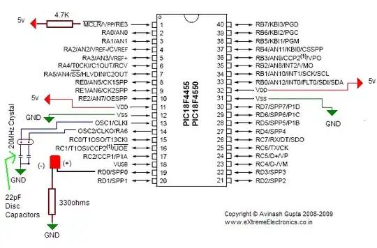

I'm using a PIC 18F4550 to blink an LED in a breadboard through a resistor. I think the circuit is correct because a simulation with Proteus works fine.
The physical circuit doesn't work unless I hold the LED with my hand. When I release my hand it stops.
I used a typical 0.1uF ceramic decoupling capacitor between Vcc and Vdd.
now I connected the two pairs of (vcc ,ground)
What could be the cause of my problem?

    All power pins should be connected, also the wires from C1, C2 to Vss should be quite short. It should work when you do that, though 20MHz in a breadboard is usually not recommended. – Spehro Pefhany Aug 19 '14 at 17:13

  • Connect both pairs. Does it work now? If not update your question. Your diagram shows a 16F877 and you mention PIC18. Which is right? – David Aug 19 '14 at 17:18

  • @David ok sorry it's PIC18F4550, now I connectd the both pair, but still not working, I should hold by hand – Lkaf Temravet Aug 19 '14 at 17:23

Connecting BOTH pairs of VDD/VSS is absolutely required. Connecting only one pair is not optional and may produce unpredictable results. And it's wise to put decoupling capacitors on each pair separately.
The behavior associated with the proximity to your hand may be because you left the PGM pin unconnected. If you have LVP enabled (one of the configuration bits in your code), the PIC will go into programming mode if the PGM pin is driven high. The PGM pin should be tied to ground for normal operation. But if that pin is left floating, it acts like an antenna and any nearby electrostatic force (your hand) may cause it to swing high or low. However, if you do not have LVP enabled, that is unlikely the problem.
On another note, Microchip recommends a resistor between MCLR and VDD. A 10k resistor is common.

  • it works fine but by putting PGM down (to ground), are you sure PGM should be high (vcc) – Lkaf Temravet Aug 19 '14 at 17:44
    As I said in my answer, it will go into programming mode if it's driven high. So forcing it to ground, as you have now done, allows the PIC to run normally. Just remember to remove that wire when you program it or your programmer may not work. – Dan Laks Aug 19 '14 at 17:49
  • I've edited my answer to clarify the PGM should be tied to ground for normal operation. – Dan Laks Aug 19 '14 at 17:52
