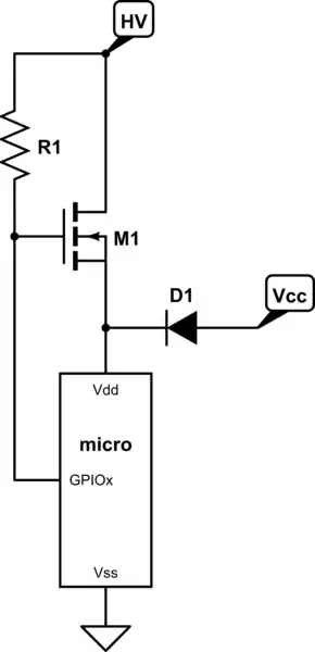

Designing an external circuit that destroys the chip at will is not trivial too in my opinion. The first thing that comes to mind needs a somewhat high voltage power supply, a nmos and a resistor:
schematic
simulate this circuit – Schematic created using CircuitLab Where:
  • \$V_{CC}\$ is the usual supply for the micro, some 3v3 to 5V or whatever is needed
  • HV is a supply which voltage is well above the absolute maximum ratings of the micro
  • D1 is there to protect your valuable 3V3 voltage source
  • R1 pulls the mosfet gate high when the micro is not keeping it to ground
  • M1 is the designated killer
the operation is simple: if the micro releases GPIOx M1 turns on, Vcc rises and your chip catches fire. Note that this is a crappy setup, for example HV must be turned on after you are extra sure that GPIOx is firmly held to ground. Some transistors might not like some -5V Vgs, and so on... But you get the picture.

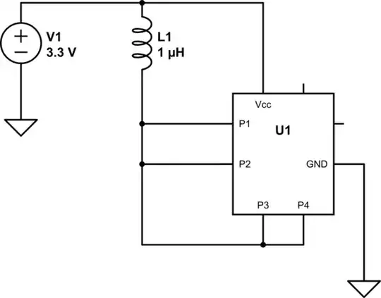

This is my entry for ruining a microcontroller with as few parts as possible...
Just toggle the output pins at a few kHz!
You still might not see smoke, depending on the internal failure mode though.
schematic
--Edit, added Aug 22--
Now, I don't think you can ruin a microcontroller with the criteria given. But you can EASILY ruin external circuitry with the wrong code. A example that comes to mind is a simple boost converter I designed recently... simply pausing the code while debugging could short an inductor to ground through a MOSFET. POOF

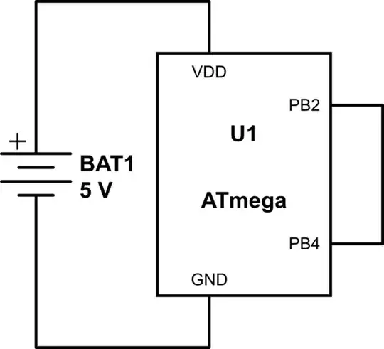

schematic
#include <avr/io.h>
int main(void)
    DDRB |= _BV(2) | _BV(4);
    PORTB |= _BV(2);
    PORTB &= ~_BV(4);
    for (;;);
The code above causes the MCU to push PB2 high while pull PB4 low, and this creates a short circuit from VDD to PB2 to PB4 to GND and quickly the port drivers of PB2 and/or PB4 will fry. The short circuit may be an innocent error like accidental soldering bridge.
Maxthon Chan
  • 2,873
  • 16
  • 34
  • I'm skeptical that this would work. IO pins usually can't source or sink large amounts of current. The IO driver transistors would limit the current. – Adam Haun Mar 24 '16 at 06:11
  • @AdamHaun The problem is that there is no current limiting exist. What is happening here is that this circuit can burn those transistors. – Maxthon Chan Mar 24 '16 at 06:13
  • The current limiting is from the size and gate voltage of the output drive transistors. Maybe a 5V AVR could burn out the drivers, but looking at ATMega typical driver strength charts, with 3V Vcc shorting two pins together might not even exceed the absolute max pin current. And the current goes down at high temp! Lower-power MCUs would probably be fine. – Adam Haun Mar 24 '16 at 16:29
