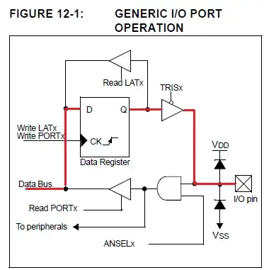

Let's use the picture in manual:
Generic I/O Port Operation
When you write a bit in a I/O pin, you're storing this bit from Data Bus to the Data Register (D-FlipFlop). If TRISx of this bit is 0, so data from Q of the Data Register will be in the I/O pin. Write in LATx or PORTx is the same. See below in red:
Generic I/O Port Operation Write

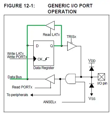

On the other hand, read from LATx is different of read from PORTx.
When you're reading from LATx, you're reading what is in the Data Register (D-FlipFlop). See picture below in green:
Generic I/O Port Operation Read LATx

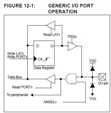

And when you read from PORTx, you're reading the actual I/O pin value. See below in blue:
Generic I/O Port Operation Read PORTx
