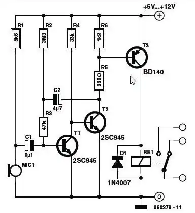

The first step will be to construct your sound detection circuit. You can probably find a schematic online for something that turns on LEDs (VU meter, for example) or look for sound-activated switch circuit (such as this example). They typically use a small electret microphone. Build your circuit on a breadboard and experiment with position of the microphone in relation to the sound. That may give you an idea of how sensitive it is (or not) and help get you started.
A microcontroller-based circuit will give you more flexibility, such as doing as I described above, taking multiple samples and evaluating them. If you're just starting with electronics, I don't recommend a microcontroller-based project as your first one. (But the Arduino platform is a great starting point for doing so.)
The circuit example I linked in the previous paragraph will be more basic, turning on the relay for a short time period set by C2.
Schematic
For now, I would just use the relay to operate some other battery-powered device, so you can figure out how it works. When satisfied, check with someone more experienced to help you select and configure a relay to operate a mains-powered device or appliance.

  • Thank you very much. I will look for someone more experienced person when i'll start working with appliances. One question though, what does RE1 means is the schema? And near the ground (the circle inside the circle, that the ground right?), theres a black rectangle, what is that? – Someonation Aug 12 '14 at 05:41
  • RE1 is the relay coil. The black rectangle at bottom is ground, while the circle appears to be a connection terminal -- basically, where the negative terminal on the battery connects. (It's not the best schematic I've ever seen.) – JYelton Aug 12 '14 at 06:36
  • Should I get a specific relay coil? And some of the resistors has a digit after the unit. for example "5k6" or "3m3".what does it mean? – Someonation Aug 12 '14 at 17:36
  • A typical relay has a built-in coil, which is the electromagnet that moves the switch contacts. The schematic diagram is just illustrating that the pins of the relay that connect to the coil are the ones to connect to the low-voltage side. Values are often shown using the unit in place of the decimal point to save space. So 5.6k is the same as 5k6. 3M3 would mean 3.3M. Notice the M is capital, which means mega or 1x10^6. A small "m" denotes milli which is 1x10^-3. – JYelton Aug 12 '14 at 18:07
