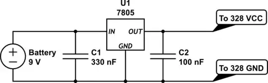

The Atmega328 can take 5.5V before you risk damaging it. This is why most Arduinos will use a USB connection to draw power from. Since you want to use a 9V battery, you will need some sort of voltage regulation to push it down to acceptable levels for the ATmega328.
You chould use a linear voltage regulator like this one for example. These are vary widespread and can be adjustable as to which output voltage they will make. Many are fixed as well.
First off, you will connect your 9V battery to the input rail of the voltage regulator. Make sure you put the postive terminal to the input pin of the regulator and connect the negative terminal to the GND connection of the voltage regulator. It is wise to attached a capacitor on the input rail going from the positive terminal to the negative terminal.
After you have the battery hooked up to the voltage regulator, you will have 5V being created on the output of the voltage regulator. At this point you'll connect the output pin to the VCC pins of the ATmega328. Make sure you connect the GND pins to the voltage regulator as well. It is also wise to put another capacitor on the output voltage rail as well, one lead to the 5V rail, and the other lead on the capacitor to the GND rail.
schematic

    Don't expect a 3-terminal regulator to work well without capacitors. – Chris Stratton Aug 07 '14 at 20:35
  • @ChrisStratton Ah good catch! I've updated the schematic and the description – Funkyguy Aug 07 '14 at 20:46
  • @gwideman Fair enough, I didn't want to seem too pushy. nevertheless, I removed the mention of a voltage divider so that voltage regulators are the only item discussed – Funkyguy Aug 07 '14 at 20:48
  • Of course a 3-terminal regulator is just a voltage divider with a feedback control circuit to adjust it. – Chris Stratton Aug 07 '14 at 20:49
  • @ChrisStratton ...if OP is having a hard time trying to figure out how to power an ATmega328, I doubt we need to go into that...but yes, you are right. – Funkyguy Aug 07 '14 at 20:50
    You refer to L7805 as an LDO, that is not the case, the device has a dropout voltage of 2-2.5v. A commonly used low dropout regulator is LM1117 with a voltage drop of 1.3v. It would probably fit better the task and would be able to provide a 5v output for a longer duration. – alexan_e Aug 07 '14 at 21:21
  • @alexan_e good catch, fixed. – Funkyguy Aug 07 '14 at 21:36

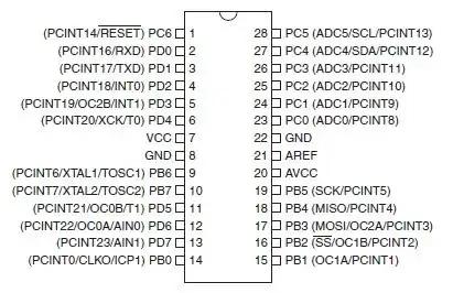

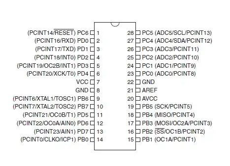

All of the specifications, pinouts, and diagrams are provided in the ATmega328 datasheet. The pinout shows you what pins to connect to Vcc and Ground, etc.
ATmega328 Pinout
As for a schematic, you won't likely find anything pre-designed for use in Eagle. The ATmega328 is just a microcontroller, and could be connected to pretty much anything you want on your own PCB.
