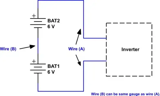

The wires connecting the batteries can be the same gauge as those connected to the inverter, as the current will be the same:
schematic

  • The wires connecting the batteries to each other can be the same gauge as the wires to the inverter. With the batteries in series, the current will be the same. – JYelton Aug 06 '14 at 00:47
