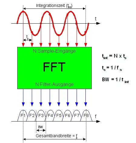

-4
look at this pic. its clear. relation between fs and fft resolution
Hamid
  • 15
    It's not totally clear from this picture what's going on. (It doesn't help that the picture isn't in English.) What does this add that the other answers haven't mentioned? – Greg d'Eon Nov 09 '15 at 13:17
