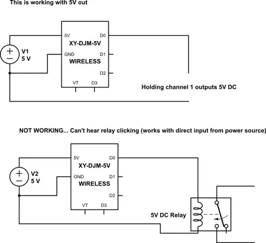

I'm just a beginner and need some assistance. below is a diagram of a 4CH reciever which works fine with some leds and it reports 5V positive on Data0 when holding channel 0 on the transmitter. What's not working is when attempting to use a 5V DC relay as shown in diagram, the relay clicks and seems to work fine with a direct input.
I'm using USB Powered socket which is 5V DC 0.5A I believe. I'm really puzzled while its not working.

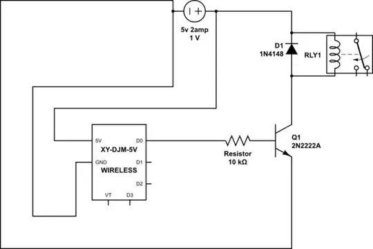

The relay draws more current than that module can supply. If you keep doing such tests you may damage the receiver!
If you read the SC2272-M4 datasheet, you'll see it can supply a maximum current of 3 mA. That relay needs 89 mA at a 55 ohms coil resistance. So the load current is 5 / 55 = 0.09 A = 90 mA. Now, the minimum hFE of the transistor should be (0.09 / 0.003) x 5 = 150. The resistor between receiver and transistor base should be 0.2 x 55 x 150 = 1650 ohms. Choose 1.8 k. Calculations made on http://pcbheaven.com/wikipages/Transistor_Circuits/
Due to the very low available current from receiver output pin, a high hFE transistor is required. 2N2222 should work (its maximum hFE is 300).
Use a (transistor) driver. Something like:

  • Ya I thought it could be the amps, didn't relise I could break it through.. Will need to buy transistor. Additionally, are you recommending 2 power sources, or one but both input on both with more AMPS. – Simon Hayter Jul 30 '14 at 17:15
  • I've edited my suggest and added what I believe it is your suggesting.. can you confirm thats right or wrong, with any other improvements, :) – Simon Hayter Jul 30 '14 at 17:25
  • Is there any reason why you use the diode between the coil pins? I'm sure this has been asked time and time again on here, if you know a question / answer on here that may help then let me know. thx for all your help. – Simon Hayter Jul 30 '14 at 17:29
  • @bybe http://electronics.stackexchange.com/questions/110574/how-to-choose-a-flyback-diode-for-a-relay and http://electronics.stackexchange.com/questions/115857/flyback-diodes-and-relays – Cornelius Jul 30 '14 at 17:32
  • Awesome, I'll read that in a moment. In the meantime I'm ordering the parts which is a 10K resistor, a 2N2222A Transistor... the diode, should any work? – Simon Hayter Jul 30 '14 at 17:40
  • Sorry, but you know mention 1.8K resistor, is this instead of the 10K as previously discussed? – Simon Hayter Jul 31 '14 at 13:07
  • @bybe yes, instead of the 10 k resistor. – Cornelius Jul 31 '14 at 13:53
  • Sorry to bother you again Cornelius, I'm not thinking of using a 12v receiver, obviously the current will change so I guess I will need a different resistor would 3K be good enough? – Simon Hayter Aug 02 '14 at 15:54
