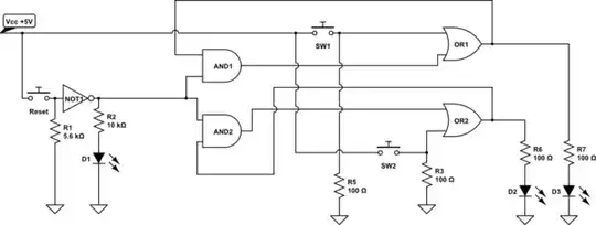

I realized on a breadboard the circuit below
schematic
Sorry, in the image some resistors are wrong: R5 = R3 = R1 = 5.6k Ohm R6 = R7 = 10k Ohm
I used 74LS04 for the NOT gate, 74LS08 B1 for the AND gates and 74LS32 for the OR gates.
Being LS, I connected all the unused input to ground, while every other input shall be connected, because I tried to use pull-down resistors on the inputs.
Now, this is the first time I try something this complex: I know this is conceptually simple, but I just don't have the tools and knowledge to deal with the hardware fabrication.
In fact, this circuit is not working as I was expecting: even if the reset button is not pressed (or even if it is pressed), the NOT gate will always produce an output voltage of 0.75, which is (I think) low. In fact, the SW1 and SW2 buttons will just turn on the LEDs when they are closed.
If I remove the link that goes from the NOT gate to the AND gates, leaving only the D1 LED as output, the NOT gate works as expected.
As additional input: the chips are connected properly to Vcc and GND (+5V and 0), and I am using, as a power source, a stabilized power supply (that is actually a recycled computer PSU).
Well, that's all for now... Can someone give me an advice? I can't really understand what's happening (and why).

The concept looks sound.
The main thing I see is that your 5.6K resistor is way too high to guarantee a low level for a 'LS04. The 100 ohm resistors you used elsewhere are okay (but they'll get warm if the switch is held).
Suggest you use ~150 ohms for the pull down resistors and maybe 4.7K for the LED resistors.
It would be better to use a spare inverter for each of the LEDs (so the output is low for LED 'on') and connect the LED + resistor between Vcc and the output. That's because you're loading the outputs with the LED and TTL can't source current that well. Then you can use 470 ohms or even less for the LEDs and they'll be much brighter.
Spehro Pefhany
  • 397,265
  • 22
  • 337
  • 893
  • Are 330 also Ok? – AkiRoss Jul 24 '14 at 17:36
  • Using 330 ohm resistor worked!! :D Thanks so much! – AkiRoss Jul 24 '14 at 17:39
    Yes, 330 * 0.4mA maximum input current is 132mV, easily good enough. – Spehro Pefhany Jul 24 '14 at 17:41
  • Thanks a lot, also for your tip about using the inverters – AkiRoss Jul 24 '14 at 17:44
  • I've read this many places. Is an inverter not considered TTL like the other logic gates? Also, are inverters typically designed to be used as buffers and consequentially typically have greater fanout and output current provisions? – sherrellbc Jul 24 '14 at 19:35
  • TTL can sink about 10x as much as it can source if you want it to stay within valid logic levels. 0.4mA/4mA for 2.5V/0.4V out (limits). If you're an evil person and you don't care about logic levels (or have a green or blue or white LED) you could even leave out the series resistor if its sourcing (not recommended) and it probably wouldn't fail immediately, since there's 120R internally (nominal) and at least a Vbe drop, so with a 3V LED you'd get about 12mA. But it's bad. – Spehro Pefhany Jul 24 '14 at 19:44

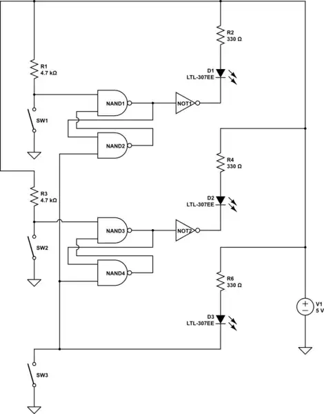

As a result, you should not use pull-down resistors on inputs. Use pull-ups. Likewise, if you are using switches as inputs, tie them to ground, and use a pull-up resistor. Spehro has mentioned about driving LEDs by pulling them down, rather than trying to force them high. With this in mind, your circuit ought to look like this
schematic
Note that the reset switch does not need a dedicated pull-up resistor, the LED serves the purpose.

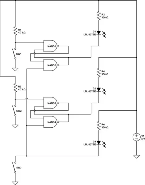

And, if you think about it, the circuit can be simplified further:
schematic
simulate this circuit
The only potential drawback to the simplified version is the requirement that the LED current be within the spec for low output current. If you try to draw too much current, the voltage at the other gate input may be too high for proper operation. In the case of the 74LS00 http://www.ti.com/lit/ds/symlink/sn74ls00.pdf, the recommended max low output current is 16 mA.
