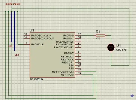

I want to blink LED with PIC16F628A and run it directly with the button make and program device main project of MPLAB X. to programing the PIC I did simple wiring shown in this tutorial without using any resistor (just wiring).
To blinking the LED I just wired RA0 ---> resistor ---> LED ---> ground but nothing works.
Should I remove some wires after programming the PIC or add something?

  • And i just have to wire the led ground to vss ???(already wired to pin 3 of pickit) – Lkaf Temravet Jul 22 '14 at 16:09
    OK, that sounds correct then (Vss should already be wired to PICkit-pin3). I would verify that your LED works, is oriented in the correct direction and that all your wiring is correct at this point. – kjgregory Jul 22 '14 at 16:17
  • i did exactly like that (see picture above ). I just added led to RA0 and vcc (pin 5) but nothing works, simulation with Proteus works fine, the PIC is detected and successfully programmed either with MPLAB or Pickit2 software. the led direction is correct (light with vdd ground Raspberry) – Lkaf Temravet Jul 22 '14 at 16:42
  • It looks like you may have the PICkit connector inserted backwards on the breadboard. – kjgregory Jul 22 '14 at 17:21
  • no it's not inserted backward, it's detected by the pickit, (see last picture) :) . – Lkaf Temravet Jul 22 '14 at 17:25
  • Well, looking at the wire colors in reference to the tutorial you linked, orange is Vpp, you have it wired to nothing. Grey is aux (not used), you have it wired to Vpp. If it's working, then you must have connected the jumper backwards on the PICkit as well. – kjgregory Jul 22 '14 at 17:34
  • I dont think those colors have sense since it the tutorial there is colors white and red that doest exist in the real pickit wire and since it's detected then it's well wired, and when I reversed pickit wires nothing detected. (it's just difference of color, I made the right order) – Lkaf Temravet Jul 22 '14 at 17:39
  • I don't see the resistor in the picture, is it hiding behind the LED? Have you verified that the LED lights up when you connect the resistor directly to Vdd? – kjgregory Jul 22 '14 at 17:42
  • I didnt put resistor betwenn RA0 and led, I didnt put any resistor here, for what purpose??? – Lkaf Temravet Jul 22 '14 at 17:51
  • no I added resistor between RA0 AND LED still not working, workds when set VSS rasberry -> resistor -> led -> ground (it lights this way) – Lkaf Temravet Jul 22 '14 at 17:54

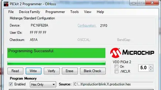

Your code sets the PIC to use MCLR reset but you have nothing pulling you MCLR up to vdd. AFAIK the PICkit2 wont pull it up to vdd but will simply release it. You can add an external resistor pulling your MCLR to Vdd or you can try your code with:
--- __CONFIG(FOSC_INTOSCIO & WDTE_OFF & PWRTE_ON & CP_OFF);
+++ __CONFIG( FOSC_INTOSCIO & WDTE_OFF & PWRTE_ON & CP_OFF & MCLRE_OFF );
I have to point out, even though it may seem basic to some, that LEDs cannot work in reverse, if you are not 100% certain that you have the polarity correct, try reversing the LED (very few LEDs have maximum reverse voltages lower then 5V so this should not be able to damage the LED or the PIC).
Also, dont forget to power your circuit. You have to explicitly tell the PICkit (especially the PICkit3) to power the host circuit otherwise it will assume the circuit has it`s own power supply and it will not feed power to your circuit.
In the PICKit2 interface (your image):
  1. check the "VDD PICKit2" - "ON" box to instruct the pickit to supply power to your circuit.
In the MPLABX interface:
  1. right click on your project
  2. click properties
  3. in the tree on the left of the properties window (titled categories), click PICkit 2
  4. Uncheck the "Use target power always" box
