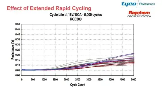

  • Raychem indicate that rapidly cycled polyfuses do have a finite cycle lifetime.
See the diagram below, taken from the useful [PolySwitch PPTC Device Principals of Operation] (sic) seems likely to be similar to the Littlefuse document which you are not permitted to share - maybe this is why :-). The original link is broken as of August 2022. A less readable but adequate version is here.
As Tyco / Raychem publish this curve publicly they may be a better source of information on lifetime and cycling, even though not the brand you were working with.
The term "extended" here suggests to me that they consider 1000+ cycles a non-standard application. I do not know what "rapid" means in this context.
As trip point is closely related to device temperature (and can be affected by eg thermal effects of adjacent contacting metalwork, PCB track thermal characteristics and air flow) then it is essentially certain that trip current will decrease as on resistance rises. As noted by others, as power dissipation is related to I^2.R and as I is established by external circuit elements, it looks likely that trip current would start to fall from about 750 cycles onwards for the example in the graph.
The Polyswitch or Polyfuse was invented by Raychem Corporation (now TE Connectivity).
How well their data applies to competitors products is uncertain but components using the same basic principal seem liable to share somewhat similar characteristics, including cycle lifetime.

Resistance post-trip will be "reset" to some value > Rinitial and <= Rimax after each trip, but apart from this, increases are non-cumulative with multiple trips. In view of the Raychem curve at the top of this post, that conclusion seems liable to be true for only a 'sensibly small' number of cycles
[for selected and limited values of "sensibly" :-) ].

BUT, as above, "In view of the Raychem curve at the top of this post, that conclusion seems liable to be true for only a 'sensibly small' number of cycles
[again, for selected and limited values of "sensibly" :-) ]."
