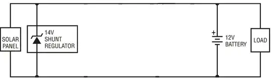

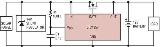

This is about as simple I would care to get, the Ideal Diode.
Solar Panel Charging a Battery
Or you could just have the battery pull down the solar panel output (typ. 18V) down to 12-14V. NOT RECOMMENDED

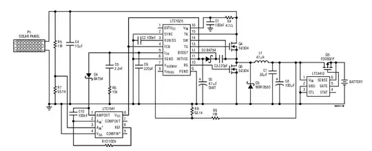

IF YOU WANT TO DO IT RIGHT
Use a Peak Power Tracking Buck Solar Charger to Maximize Efficiency
