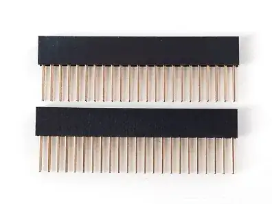

have pins that are too short to stay put in the breadboard, but the so-called stacking headers such as these:
Stacking Header Set for Beagle Bone Capes (2x23) from Adafruit
have pins that are too long and too thin.

I know I can get the stacking headers and trim them, but there has to be a tidier solution.

  • "Stacking" headers are a non-standard part. Adafruit and other Arduino markets have settled on an extra long tail. – Passerby Jul 13 '14 at 02:31

There is a very nice solution for your problem, way back in the days (no clue how many days, I'm too young for that) manufacturer's (and hobbyists?) didn't always solder pins, they wire wraped them. Basically the header or mcu adaptor had really long legs so you could wrap a wire around it multiple times to form a decent connection. But since the only difference in headers between wire wrap variants and normal ones are longers legs, they are perfect for your breadboard.
Link: http://www.gravitech.us/208wiwrfehea.html http://en.m.wikipedia.org/wiki/Wire_wrap
