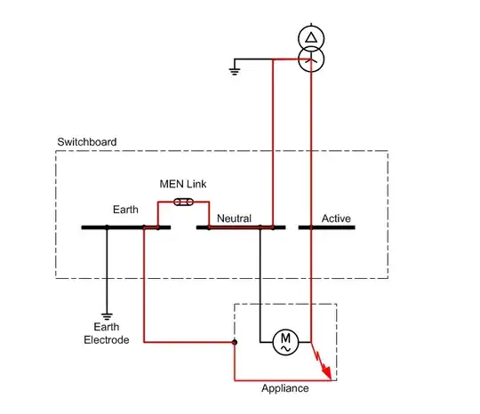

In my country (Australia) we use an earthing system that looks like this:
In case of an earth fault, the fault current path looks like:
Note the connection between the earth bar and the neutral bar at the "MEN link". The "earth fault path" doesn't actually go through the literal earth, i.e. the dirt - it goes through copper wires the entire way.
The above diagram shows what happens if your active wire faults to earth, but the same thing happens if you connect your active wire to earth directly.
NOTE: The above pictures show a "multiple earthed neutral" or TN-CS earthing system to AS/NZS 3000. The earthing arrangements in your country may differ significantly.
