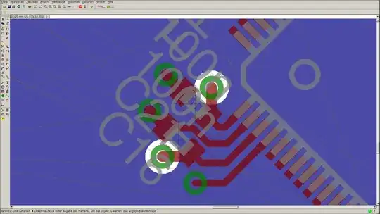

I'm (again) placing bypass capacitors around an FPGA, and can't seem to get to a sane solution, given that I have all the pins assigned, and the supply pins are right in the middle of the I/O pins.
As an example, placement around pin 1:
Bypass Capacitor Placement
The next pin is another supply again (I can manage that, but I get further and further away), then a few I/Os, then another supply of the high ripple kind right in the middle of the package side.
So far, an avenue I haven't yet explored is shrinking the footprint (I use the standard 0402 from Eagle, which are humongous), and I'm wondering whether I can sensibly do so, and how big I need to leave the SMD pads in order to keep a strong connection.

I put bypass capacitors on the back ("solder") side of the board, inside the chip outline, with the vias inder the chip - that keeps them out of the way of the signal lines.
Peter Bennett
  • 59,212
  • 49
  • 132
  • That's what I did. – Nazar Jul 07 '14 at 21:52
    Massively increases the production costs though if you're getting it fabricated. Double-sided loadouts are costly. – Majenko Jul 07 '14 at 21:52
  • @Majenko given that he already has via, he must have at least 2 sided board. – Nazar Jul 07 '14 at 21:54
    @Naz I don't mean copper on both sides - I mean components on both sides. Placing those components in a production situation (factory) is much more expensive than just having them on one side of the board. – Majenko Jul 07 '14 at 21:55
  • Yes, that is plan B -- however I have ~150 components in 0402 packages, so I'd definitely like to keep an eye on automated production in the long run. – Simon Richter Jul 07 '14 at 22:04

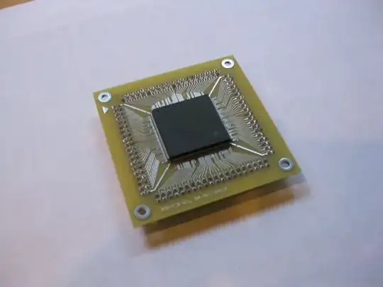

Often when doing PCB layout I cram all the parts on the board. Then later -- when laying the traces -- I find out I don't have enough room between the parts to run all the wires.
In particular, fine-pitch components like TQFPs need a lot of room around them to "fan out" their wires, sometimes more room than I expected. (PCB layout artists find it requires even more resources to fan out BGA packages).
I generally end up spreading the wires apart something like this, to give myself plenty of room for capacitors and via patterns and other kinks in the wires between the components:
(image from FPGA-Based Retrocomputing http://www.fpgaretrocomputing.org/pdp10x/ )

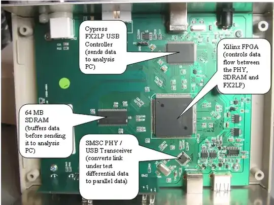

I typically end up with capacitors on the same side of the board as the chip, with the +VDD end of the capacitors pointing directly at the chip, and the GND end of the capacitors pointing away from the chip, as in figure C of " Best place to place a decoupling capacitor ". Occasionally I end up with capacitors on the same side of the board as the chip, with the capacitors going "across" the fanned-out traces, as in C19 in the top image at " Decoupling caps, PCB layout ". (But as I said before, more often like C17 in that image).
This generally means capacitors left and right of the chip are horizontal, while capacitors above and below the chip are vertical. However, sometimes it is convenient to have capacitors near the corners placed diagonally, like several of the capacitors connected to pins near the upper-left corner of this Xilinx FPGA:
(from http://www.summitsoftconsulting.com/UsbAnalyzers.htm ).
