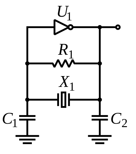

The devices with two pins are not oscillators, they are resonators (crystals), which can be used in an oscillator circuit (such as a Pierce oscillator), and if used with the correct circuit will oscillate at (or near) the marked frequency. The Pierce oscillator circuit, shown below, uses two capacitors (load capacitors, C1/C2), the crystal (X1), and an amplifier (U1).
The devices with four pins are complete circuits including a resonator and an active circuit that oscillates. They require power and output a square wave or sine wave output at (or near) the marked frequency.

Crystals below their resonant frequency appear mostly capacitive. Above their resonant frequency, they appear mostly inductive. At their resonant frequency, they appear mostly resistive.
Re-draw the Pierce oscillator three times, replacing the crystal with one of those components. It may help you understand how it works.
Parallel resonant crystals are actually specified a little bit under the fundamental frequency. This makes the crystal appear a bit capacitive at the spec'd frequency. The additional capacitance adds a bit of additional phase shift to help the oscillator start and run.
