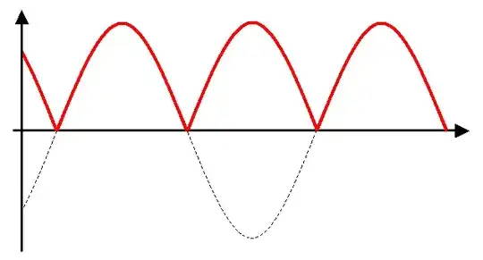

Just look at the waveform.
If a sine wave goes through a complete cycle every t, and you full-wave rectify it, there will now be two upward humps in every t. Since each hump is a complete cycle, you've doubled the frequency:
More generally, a perfect full-wave rectification means the response function has even symmetry. This means that, for a sine wave input, the output will consist of only even-ordered harmonics, starting at the second harmonic, which is 2× the fundamental.
http://en.wikipedia.org/wiki/Even_and_odd_functions#Harmonics

  • You said in words: Rectification is a non-linear process so it can change the spectrum of a signal what endolith said in a picture. Unfortunate that he's got more upvotes.... – Kevin Vermeer Mar 21 '11 at 21:42
  • @reemrevnivek: His picture is nice and his remark about even and odd functions is better than my hand-waving (despite both having their uses) so I don't envy him. :) But thank you for your support. – jpc Mar 21 '11 at 23:40
