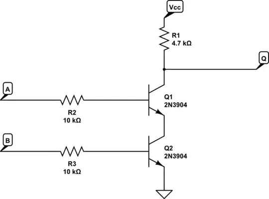

For example, a TTL NAND gate typically uses 2 transistors (NAND gates are considered one of the fundamental building blocks of logic, along with NOR):
schematic
As the technology transitioned from TTL to CMOS (which is now the de-facto standard) there was basically an instant doubling of transistors. For instance, the NAND gate went from 2 transistors to 4:
schematic
simulate this circuit
A latch (such as an SR) can be made using 2 CMOS NAND gates, so 8 transistors. A 32-bit register could therefore be made using 32 flip-flops, so 64 NAND gates, or 256 transistors. An ALU may have multiple registers, plus lots of other gates as well, so the number of transistors grows rapidly.

  • NAND = 4 not 2 Transistors and FF's are more than just 2 NORs – placeholder Jul 01 '14 at 14:16
  • NAND is 2 transistors, for example: http://cpuville.com/logic_gates.htm. A simple SR takes 2 NANDs. – Majenko Jul 01 '14 at 15:32
    Oh my! you really need to rethink that. Show even ONE design that has Million of transistors that is done in Bipolar!! ALL of these designs are CMOS, – placeholder Jul 01 '14 at 15:59
  • The first two paragraphs explains very well the use of transistors. Talking about bipolar transistors is okay for the sake of simplicity, but you shouldn't use that as the base unit for "counting" transistors in a chip. @placeholder is right, every digital chip uses CMOS.. – strnk Jul 01 '14 at 16:25
    Fair point. Added a second schematic to highlight the difference, and the subsequent doubling of transistors just from that. – Majenko Jul 01 '14 at 17:08
    weak vs strong pullup is a completely different issue from TTL vs CMOS. BJTs do come in PNP, after all. CMOS does not involve "doubling of transistors". Large-scale integration does, since transistors are far smaller than pull-up resistors in any ASIC process. – Ben Voigt Jul 02 '14 at 03:52

    That is not a TTL NAND gate. That is an RTL logic gate. – fuzzyhair2 Jul 22 '14 at 12:49
  • @BenVoigt: CMOS generally involves doubling the number of active transistors compared with NMOS, though NMOS requires using a lot of passive-pullups (which, though passive, are still transistors); some circuits have NMOS realizations whose active-transistor count is less than half that of what would be achievable in CMOS. Although all digital logic today is almost always CMOS, that wasn't really true until the 1990s. Even into the late 1980s NMOS was still widely in use. – supercat Mar 09 '15 at 15:47
  • @supercat: Sure, the number of transistors in NMOS (open-drain) and TTL open-collector is about the same, and about half of push-pull TTL or CMOS. Like I said, the choice to use push-pull or weak pullup is a difference axis from BJT vs FET. And the fact that on-die pullup "resistors" are really implemented by transistors agrees with my point that the transistor doubling came from LSI. – Ben Voigt Mar 09 '15 at 16:05
  • @fuzzyhair2: Wouldn't RTL have series resistors? The "transistor-transistor" in TTL is the direct coupling of an output stage to an input stage, and that NAND gate has it. – Ben Voigt Mar 09 '15 at 16:08
  • @BenVoigt: My understanding is that the reason for the two "T"'s in "transistor-transistor logic" is that a transistor pulls each a signal high and a transistor pulls each signal low; in RTL, a resistor pulls each signal high and a transistor pulls it low. – supercat Mar 09 '15 at 16:26
  • @supercat: A bit of research will correct your misunderstanding. Wikipedia has articles on the relevant logic approaches. – Ben Voigt Mar 09 '15 at 16:27
  • Although, I do apologize for overlooking the fact that the gate shown does have (useless) series resistors. It still is not the typical RTL NAND gate, however. – Ben Voigt Mar 09 '15 at 16:31
  • @BenVoigt: Okay, thanks; I'd thought TTL outputs were either totem-pole or else open-collector with *no pull-up device". I wasn't aware that it was "acceptable" for a device to have a purely-passive pull-up and still be called TTL. The base resistors aren't useless, though, unless a gate is the only thing fed by a particular output. – supercat Mar 09 '15 at 16:35
  • @BenVoigt: http://upload.wikimedia.org/wikipedia/commons/thumb/d/d4/TTL_npn_nand.svg/220px-TTL_npn_nand.svg.png – fuzzyhair2 Mar 26 '15 at 01:42
