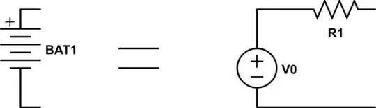

Ohm law is a law that works given a certain model of the physical thing. Using that model, a battery is modeled as shown in this figure:
schematic
If there is no current flowing out of the battery, ohm law says that there is no voltage drop in R1. Thus the output voltage of the battery is V0: the nominal voltage of your battery.
