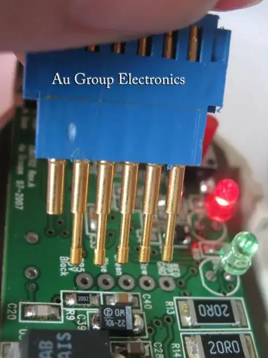

Second easiest, vias or plated holes big enough for a test clip to clip in.
Or use pogo pins on test points. The picture below shows plated holes, but some pogo pins come in pointed ends so work on smaller micro vias or simple test points.
