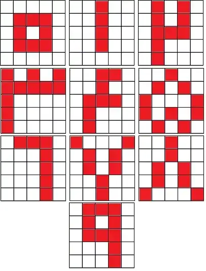

I'm a beginner in EE, so maybe the following question seems obvious to you. I have to design a circuit that gets a number from 0 to 9 via a decimal keyboard, and then show the corresponding number on a 5x5 grid of LEDs. But it's not an ordinary one because it should show the numbers in Farsi (Persian). (I've attached the figures)
Now my question is how to start to design such circuit? I really appreciate any help you can provide.
Farsi numbers on our grid:
Farsi numbers
