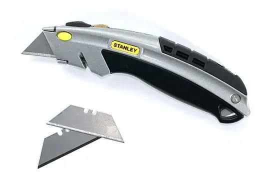

I don't know if this is the best way, but I usually score it multiple times with a heavy-duty knife (on both sides) and snap it by hand. Obviously this won't work for any non-straight cuts. The knife I use is similar to one of these Stanley knife

    Yep for straight edges this is the quickest, most accurate and more importantly the safest (no fibreglass dust)
    I find that a few scores then use a square edge and bang the ob is done.

I score it deeply with a Stanley knife on both sides and snap it, as well. A tungsten carbide tile cutter also works, but I prefer the Stanley knife. It blunts the blade very quickly, I resharpen mine with a diamond hone and can keep using the same blade indefinitely.

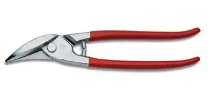

I use a big scissor (originally meant for metal sheets, I don't know the english name, see the picture)
that's perfect for the scope.

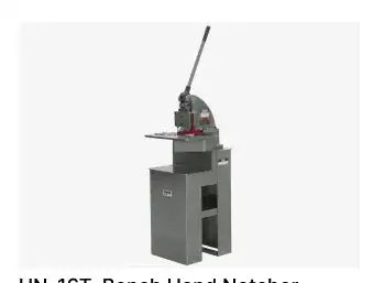

The best way? A bench notcher, it can cut through sheet metal a few mm thick and does great on PCBs leaving nice straight lines. I would use these to shear off PCBs and it could cut straight enough to not short adjacent layers
https://jettools.com/metalworking/forming/plate-notchers/
