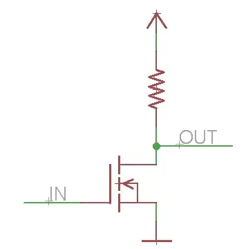

However, if simplicity or education is your goal, you can do fairly well with a simple FET inverter. With a logic-level PNP and NPN, you can make a push-pull totem-pole circuit that will have similar power requirements to an inverter IC. You can also replace the top transistor with a resistor:
inverter
This creates a simple inverter in a small space. When the input voltage is above $V_{TO}$, the output will be connected to ground through the transistor. When the input voltage is small, the transistor will be off, and the output will be pulled up to $V_{CC}$ through the resistor.
There will be power dissipation in the resistor when 'driving high' (really a passive operation for this circuit), and current will flow through the resistor when you're driving low, so make the resistor as large as your load capacitance, switching speed, and input impedance allow. This circuit can sink lots of current, but sourcing current requires a smaller resistor. If you need to source current, use a PNP and flip the design upside down. For best performance, use two transistors.

  • The original correspondent specified power consumption as a factor in the design. – markrages Mar 15 '11 at 22:20
    Why couldn't you replace the resistor with a P-channel and have a full totem-pole? – markrages Mar 15 '11 at 22:48
  • @reemrevnivek: transistor+resistor is tiny and cheap, and functions fine. 2 discrete transistors is almost as small, and I think it functions fine -- or am I overlooking something? Is there something magic about transistors inside an IC that can't be duplicated by individual discrete transistors? – davidcary Mar 18 '11 at 14:30
  • After further consideration, I've come to the conclusion that yes, you can use discrete transistors to duplicate an inverter. You can't, however, duplicate more complex logic, because your transistor has the source tied to the substrate. You need to connect the substrate (but not the sources) together for other logic circuits. Edited. – Kevin Vermeer Mar 18 '11 at 15:17
    All integrated digital CMOS designs I've ever seen connect all the nFET substrates together. But is that really necessary? What happens when you build "more complex logic" out of individual discrete transistors, each of which has its own source tied to its own substrate? – davidcary Apr 02 '11 at 04:58
