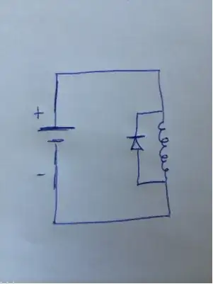

For your diodes in the relay they aren't on the right spot indeed. It's called a flyback diode and should be wired like this.
flyback
Also check the Wikipedia site.
Secondly I see that you're giving the positive power to your relay using the 7805 IC. I suggest to give an output of your pic to high and connect the other side of the relay to the GND. Since the output of the PIC should be +5V.

  • I would never have done this, it seems counter-intuitive... Thanks for the link I'll go read up and try understand the theory. – Andre May 31 '14 at 13:22

Also, you're not actually giving 5V, but 4.3V since the diodes are in series. Not only that but they can't fulfill their job which is to allow the current that can't briefly stop in the inductor to loop around: put them in parallel with the coils instead of in series. Otherwise, the coil will resist switch-OFF by producing a massive voltage between its terminals which may damage the transistor, the diode, or even the regulator.

  • I checked amps used per relay and I could not understand why they would not switch. Thanks for the explanation of the data sheet. I'll read it again now that I know what to look for. Correcting the diode placement (parallel not series) did get all 5 working. The 7805CV (T0-220) does indeed get very hot. Should I consider a second one and split the relays between the two of them? – Andre May 31 '14 at 11:57
  • It does seem like the relays need more than the stated 3.75v pickup voltage. Anything much under ~4.5 and they are not happy. I measured the 7805 and it holds the 5v now for all 5. – Andre May 31 '14 at 12:00
  • They did say "Pickup voltage [is estimated to] 75% of rated voltage" but I did not expect it to be that off. That makes your diodes in series the culprits (with the small Vce of the transistor). – Mister Mystère May 31 '14 at 12:09
    All connected to the pic with 220ohm resistors on the data line (to npn base) and diodes in parallel and everything works 100% now. I'm using two 7805CVs and that seems to keep their temperature down. Thanks for all the tips. I've go re-read the relay data sheet now that I understand a bit more about it – Andre May 31 '14 at 13:21
