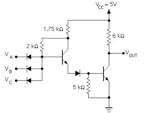

Then came vast (for the time) military demand for computers for navigation, and RTL logic was developed. enter image description here

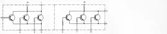

It was slow and power hungry, but it could be crammed into flat pack packages with a NOR gate or a flip-flop. It used 3.6V (my memory, verified by the RTL Logic Cookbook. which says up to 4.5V but 3.6 nominal) or 4V (schematics of the Apollo guidance computer power supply). Some other early documents indicate a 3V nominal supply.

So, it would seem to boil down to the design decision of the folks making a logic family aimed at missiles and such like that they would best use another volt or so beyond what RTL commonly used, and the tremendous pull of backward compatibility with legacy requirements. Why the extra volt or volt and a half, you ask? DTL inputs had effectively three series Si diode drops (see schematic above), and you'd want some reasonable voltage above that for the pull-up resistors to work, even with a supply 10% low and -55C temperature (military) so 4V was a bit too low, 6V unnecessarily high, and 5V about right.

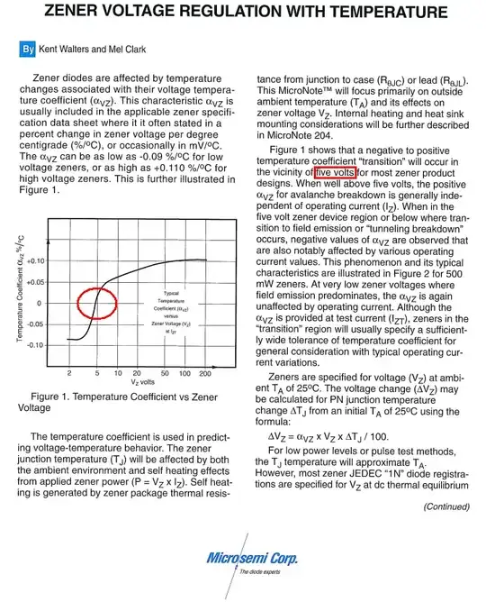

The specification for the 5V power rails for early logic supplies was quite tight (basically +/- 5%) and the voltage regulators required would need to keep in-specification despite things warming up. A regulator therefore needed a fairly stable voltage reference and I suspect this was provided by zener diodes. I'm not saying this is the definitive answer but this might be worth a read. Basically it is demonstrating that for a range of zener diodes, those that have a 5V rating are closest to having zero temperature drift: -
I guess the implication of this is that 5V voltage regulators were likely to be more stable than regulators at other voltages (back in the good old days).
