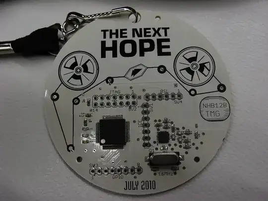

With some RFID components, you can do things like automated people tracking:
http://www.flickr.com/photos/blinkenarea/4800793412/
http://travisgoodspeed.blogspot.com/2010/06/hacking-next-hope-badge.html

markrages

  • And you can sniff Microsoft wireless keyboards... http://travisgoodspeed.blogspot.com/2011/02/promiscuity-is-nrf24l01s-duty.html – Toby Jaffey Mar 03 '11 at 16:16
  • We have used RFID cards for many years, and while fun they're more expensive. This year each visitor will get its own QR code which we'll scan on entrance and for participation in the different quizzes. – Trygve Laugstøl Mar 03 '11 at 20:05
  • Depending on the type of tech conference, you might get parts donated for PR value. That's how the Next HOPE badge was funded. – markrages Mar 03 '11 at 20:35
