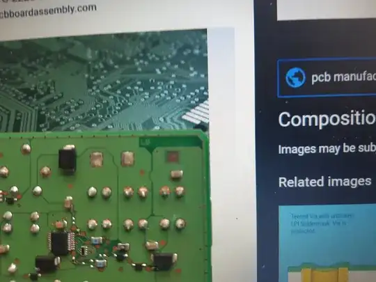

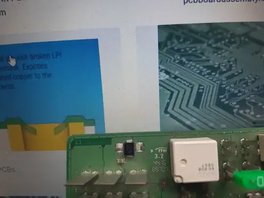

I don't know about other PCB's but all of our boards have little numbers on the corner designating what layer it is, so the top has a 1 and the back has an 8 or something, you can see the hints of other numbers too.
Daun
    Do you have a picture of this? –  Jul 19 '18 at 20:33
    When I designed 4 and 6 layer PCBs, I added these numbers to each layer. But not every designer does it and not every PCB has some free space to add those numbers. – Uwe Jul 19 '18 at 21:11
  • @KingDuken here's an example of a board I was examining, which does appear to have such a designation. This really helps, because almost the whole of front and back surfaces are covered with copper, so bright light wouldn't help seeing internal layers. – Ruslan Apr 18 '20 at 18:57
Normally all PCB's have a little number in the corner designating what layer it is, L1 in the picture below for the top side of the PCB and L6 for the bottom layer,so this PCB has 6 layers.
