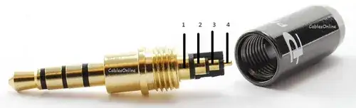

I would like to solder the following TRRS connector, which seems to be more difficult than the usual TRS connectors:
I already know the order of the connections (TRRS = left, right, gnd, mic), what I would like to know is how to make the solder neat.

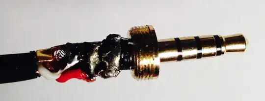

I tried putting the wires coming off to the side and it was messy and took a while to get it right such that the cover would fit back on. What is the correct way to tackle this solder job? Should I be guiding the connections sideways or straight? Do I need a smaller soldering iron because I am melting the plastic?
The idea of using magnet wire to make the connection has been offered, but I am not clear on how to do this in a way that will not interfere with the casing of the connector.

The most common mistake most people make when soldering connections like this is to use a soldering iron without enough power, which causes the connector to heat up slowly and in the process transfer heat to the plastic and melt it. The key is preparation and speed, get in get out as fast as possible and you won't melt the plastic; to do this you have to be able to get a lot of heat into the connector very quickly. The MetCal (on Amazon.com, now unavailable) soldering iron is what I use, and is ideal for this sort of task it can very quickly put huge amounts of power into the connector (if you want to know how look up how RF soldering irons work, very clever.). You must prepare the wires by tinning them first with solder, and also the connector separately. Following this, allow them to cool and ensure the tinned ends are trimmed to just the right length. After that, place the tinned wire-end on top of the tinned connected, heat with a very powerful iron for less than a second and hold the wire still while it cools, and you will have a perfect connection.

I have not yet soldered one of these well, despite having the equipment and 40 years of experience soldering. Your best bet is to not even try, throw the connector in the trash, and buy pre-soldered pigtail or TRRS breakout connector.
If that is not possible, you should accept that they are intended to take thin wires, the kind you might find in an earbud cable. If you must use something thicker, you’re going to struggle. Equipment is important. You’re going to need a soldering vice and clip to hold the connector and wire steady. Prep is important. It is usually necessary to scrape the plating off of the metal in these connectors before trying to solder. The plating and/or a coating doesn’t adhere well to solder, especially in the low-end ones (which is virtually all of them). I use a small Xacto-type blade to scrape carefully until I see the metal underneath. Then I tin the wires, cutting them to exact length, bending and forming them to the radius. I touch each to the contact long with a very hot, very thin soldering tip. It is a finesse/practice thing.
