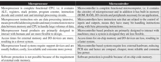

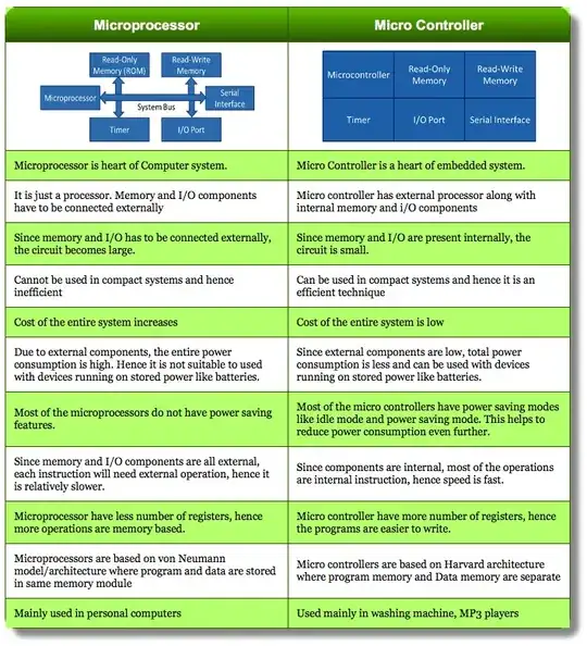

All answers are correct, as this difference more of blocks having in mC and mP, see below table,
