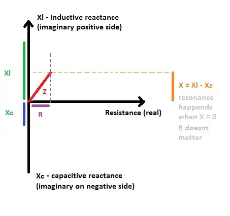

I've made a picture for better understanding of resonance:
So if resonance happends - in hypotetical ideal LC circuit there are no power losses on reactance. Energy flows from coil (magnetic field) to capacitor (electric field) and it flows back and forth with resonance frequency.
In real life some current cause thermal losses on coil windings. In capacitor some electric field is discharged by resistance between capacitor electrodes. These losses are not affecting resonance frequency but there are some other parasitic losses (inductance in capacitor, capacity in coil etc.), capacity and inductance changes due changes to environment (temperature, magnetic permeability of coil neigbourhood and they may change resonance frequency a bit.

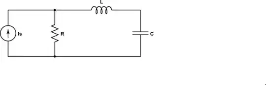

Now, let's look at the dual of the circuit given:
schematic
For the dual circuit, the impedance seen by the source is
$$Z = R||(j\omega L + \frac{1}{j \omega C}) = R \frac{1 - \omega^2LC}{1 - \omega^2LC + j\omega RC} $$
and now we have a zero at \$\omega_0\$ - the impedance goes to zero.

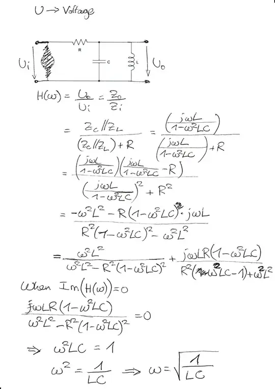

I had the same problem with the resonance freqency. When I asked someone for a general method of finding the resonance frequency of a cirquit, I was told to use the transfer function instead of the impedance accross the circuit.
If we want to use the transferr function, we need 4 nodes (2 for the input and 2 for the output). This makes sense, because the phase shift of a signal is equal to zero at resonance and a signal's phase shift can't be evaluated unless the original signal and the shifted (output) signal are known.
Now that I have an input and output signal/impedance, I can find the imaginary part of my transfer function and set it to zero. After setting the imaginary part of the transfer function to zero, I just solve for omega, and it turns out that this method works for the bandpass filter that was posted in the original question.
Calculation of the resonance frequency/angular velocity of the bandpass filter using the transfer function.
Again, it intuitively makes sense that the imaginary part of the transfer function should be set to zero because the transfer function compares the input against the output of a circuit.

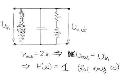

If I define U_out like this:
schematic
Effectively we just converted the original problem (without a transfer function) into a problem with a transfer function. Clearly this is not a band pass filter, if anything it's a band stop filter.
In this problem, I can show that the transfer function is equal to the impedance of the original circuit: $$ U_{out} = U_{in}\cdot(R + (Z_L || Z_C)) \Rightarrow H(\omega) = \frac{U_{out}}{U_{in}} = R + (Z_L || Z_C) = Z_{ofTheFirstCircuit} $$
so as long as the resonance frequency of this new circuit is the intended resonance frequency, it should be safe to do the calculation with the impedance rather than the transfer function. Best is to just stick with the transfer function and be sure that
As always, in the end this always applies: $$ \phi = arctan(\frac{Im(Z)}{Re(Z)}) \Rightarrow Im(Z) = 0, \phi = 0 $$ Where Z is the transfer function (regardless of whether it's equal to the impedance or not).
I hope this solves our problem. I haven't tested it on any other circuits yet so I can't guarantee that it always works, but for now I am happy with this method and I don't see any situation where it doesn't work.
