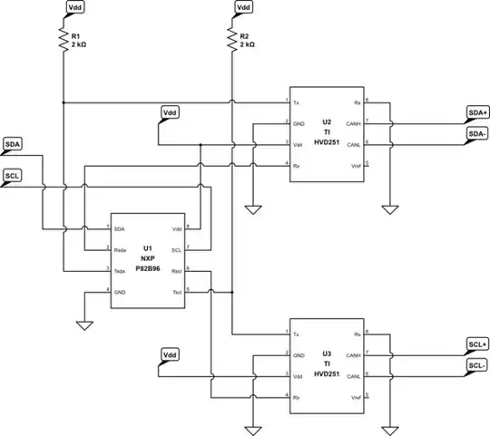

schematic
EUREKA! Figured it out! (untested, will test it out this weekend)
The interface chips are NXP P82B96 I2C buffer/splitter and 2 TI SN65HVD251P CAN bus interface chips. Essentially, I am running I2C on CAN PHY.
P82B96 understands I2C protocol and handles bus arbitration for me, and gives me separate Tx and Rx pins that can be tied together. I feed those into SN65HVD251P CAN transceiver and it gives me the bidirectional differential pair to send over wires.
Power pins comes directly, unbuffered from my Pi's 5V rail. (I will not use 12V signaling voltage and power for a while)

  • Sorry, but no. What that will allow you to do is connect two I2C units at some distance from each other. It will not allow you connect more than 2. – WhatRoughBeast Apr 23 '14 at 15:25
  • @WhatRoughBeast I have looked that up on NXP documentation and it says that this is a viable solution (and it somehow made its way into their AN) but to me, a point-to-point is okay as my design itself is asking for one pair of conversion units per Cat5e segment. – Maxthon Chan Apr 23 '14 at 15:36
  • CAN is wired-or and bidirectional just like i2c. I see no reason that this should not work with as many devices as you want on the bus. I've seen the app notr he mentions. It does appear to describe a bus, not a point to point. – EternityForest Apr 24 '14 at 05:28
  • @WhatRoughBeast - CAN is multidrop, I haven't looked too closely at what the OP is doing, but it should be theoretically possible. – Connor Wolf Apr 26 '14 at 09:23
Regardless of the merits of IIC at the chip level, your proposed implementation is going to be very difficult. The problem is bus arbitration. Although multiple units can be paralleled using, for instance, RS485, the big question will be:
How does any unit know whether it can take control of the bus in order to send data?
In IIC, with open drain signal lines, bidirectional transfer is easy - but with tristate busses you need some way to ensure that only one unit attempts to drive the bus at a time. This will be tricky. You can do it, particularly if you establish a single master and require that all the slaves have rigid timing constraints on sending data, and that they only send data if requested by the master, but this will require considerable effort on your part in designing the interface boards for the master and the slaves.
As for physical drivers/receivers, RS485 will do you fine, and there are lots of interface chips available. Just Google.
